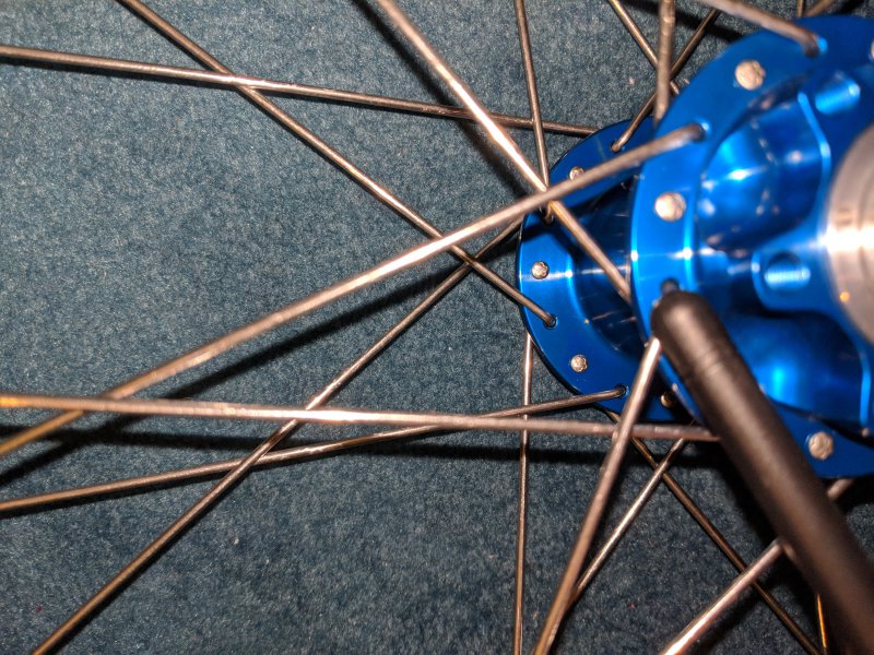

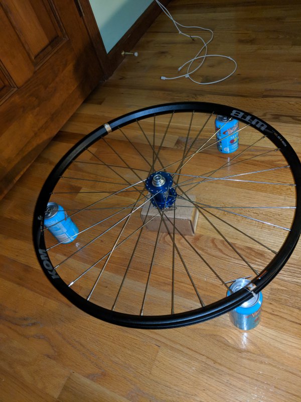

I made a mistake on my second wheel, off by one. I don’t remember ending with two spokes next to each other either, but could be wrong. If everything looks good, back out all the nipples by the same amount. You can also try to grab the hub and push it side to side in the hoop for the spokes to settle and adjust a bit.
This seems to be my same problem, need move the spokes clock wise by one. The implement is pointing to the misplaced spoke which is just right of the key spoke on the other side. The spoke should also start just to the right of the key spoke below. This is completely distracting my work today, if I don't figure this out someone's not getting their enterprise system released today...
