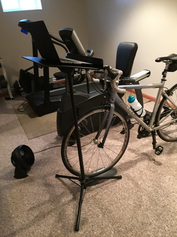

What is this ERG mode?
Every time Mrs does a workout it goes into ERG mode and she can barely rotate it with the increased resistance. Then i tapped the ERG mode on the companion app and i think i turned it off and she was able to ride again.
I dont get it. Is the Snap trainer miscalibrated?
