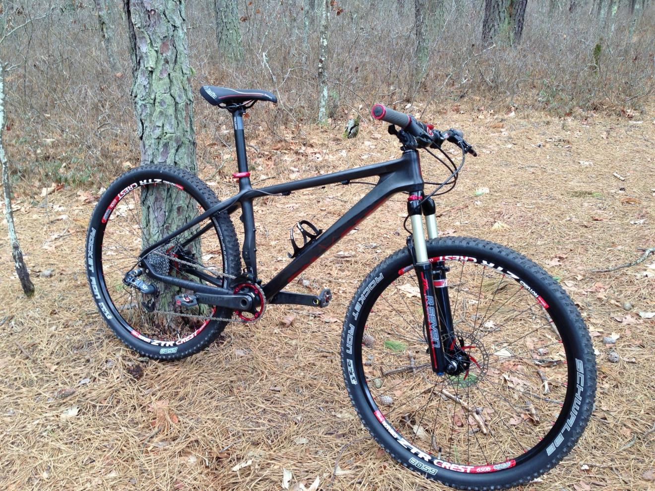

My 650b...
On One whippet frame built up as a 1x10. 20.6lbs rolls nice and very flickable.
Would not change much at all from what I built, super fun bike that fits me perfectly.

They don't list a 27.5 Whippet so assuming its a 26 converted? What size rear tire and how's the clearance? Dedicated 27.5 fork or again 26?

Yup it's a convert. The whippet has tons of rear mud clearance with 26" and popping in a 27.5" tire "looks" like it was made for it. Pretty sure a 2.2 or 2.3 would fit back there but I went with 2.1 Rocket Ron's front and rear setup tubeless. They were the closest match I could find to my favorite old 26" tires grip wise.
The fork is a Manitou r7 that I've had for sometime not a dedicated 27.5 fork. That was the one big unknown, and was fully prepped to buy a fox or Reba if it had any fit issues at all. The arch clears, and aired down fully compressed the crown clears fine. (See attached image) I've yet to induce enough flex in the wheel to rub or buzz the tire. But still may upgrade the fork at some point just because.
I didn't run this build very long on 26" tires as it was sorta started with going 650 at some point in time in the back of the mind. But none of the nimbleness has been lost.
