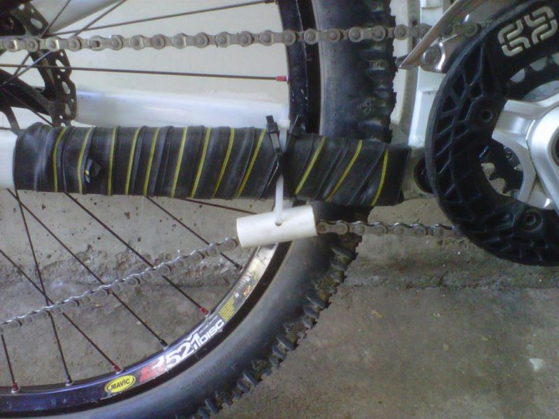

Trying to figure out if I should do something like this or machine a plate for my bb to mount a dh style tensioner so I can ss my fatboy
I decided to try a blackspire stinger as I run many different cogs. I go all the way from 16-22.
Just do this...lol
It just don't see it make for a good chain tensioner. It's mostly made for preventing chain slap and chain coming off on 1x setups before clutch derailleurs became standard. It also doesn't have a way adjust for correct for chainline. If it's on a hardtail, the Surly is ok if you have it in push up mode with some zip ties.
Well, I guess slack adjuster is a better term as I am not geared or fs so in this particular setup I will use a seperate chain for each cog size and the "adjuster" will just remove the slightest bit of "slop".Guessing it will be fine but this weekend will tell all.
