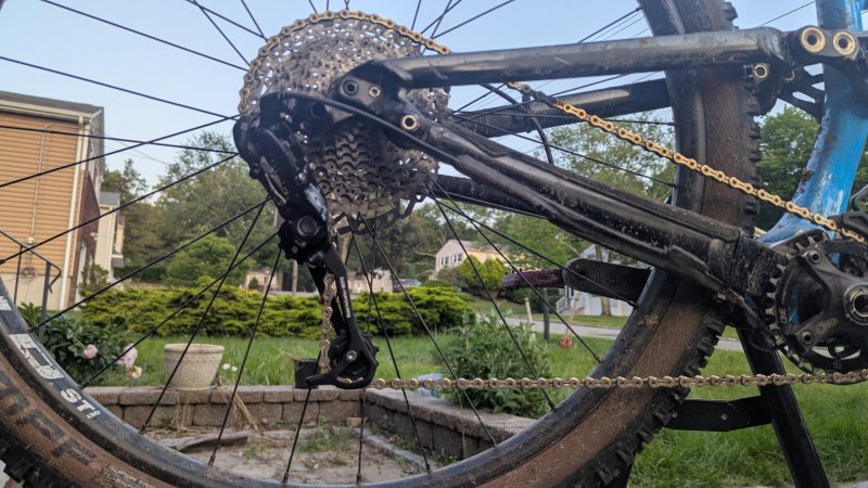

i have a 10 year old specialized enduro. the derailleur is messed up and it's time to get a new one.
the current is a SRAM GX type 2.1, 10 speed with what I now realize is a MIDcage.
the cassette is 11-42
the bike is set up as a 1x front.
i purchased and received a SRAM GX 2.1 10 speed LONG cage.
1. any reason this wouldn't work? is a long cage better, in fact, given the moderately wide range of the cassette?
2. i imagine this will force me to replace the chain because the cage is longer. - any set rule for how many more links i'll need, or is this something i need to figure out on my own once the derailleur is on the bike?

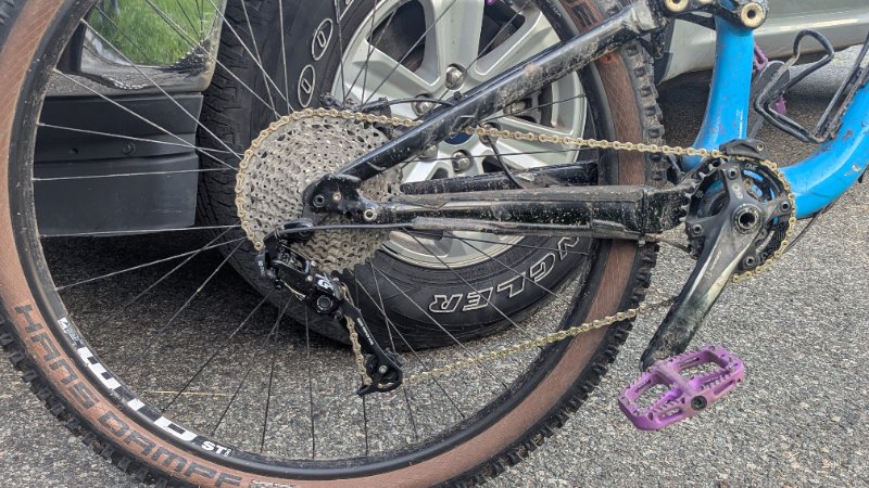

You should be fine. Just check the chain length with the derailleur in the largest cog in the back. If the derailleur is not fully extended like below, you should be OK.
